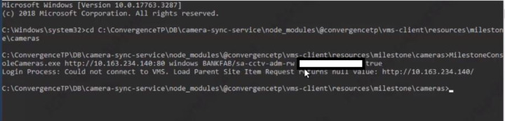

When the same credentials are used in the MilestoneConsoleCameras.exe at the UAE site they fail to return site information (LoadSiteItem the result returns null).
I only see this at the UAE Site. Here at our lab MilestoneConsoleCameras.exe works as expected.

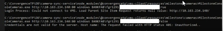

The console attached is the results when I try to login either as Federated or as a specific login to that server: First time as “Federated using LoadSiteItem…. (returns null)
Second attempt logging in as non-federated using VideoOS.Platform.SDK.Environment.Login(uri); (returns Unauthorized)
Either way MilestoneConsoleCameras is unsuccessful.

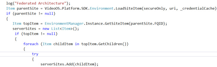

I rebuilt our MilestoneConsoleApplication with the nuget package 2022 R2 from the link above. I just tested on the customers site and I still get the same error (see below). Also I’m including a snippet of where the code is failing. The Item “parentSite” result is null.
