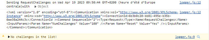

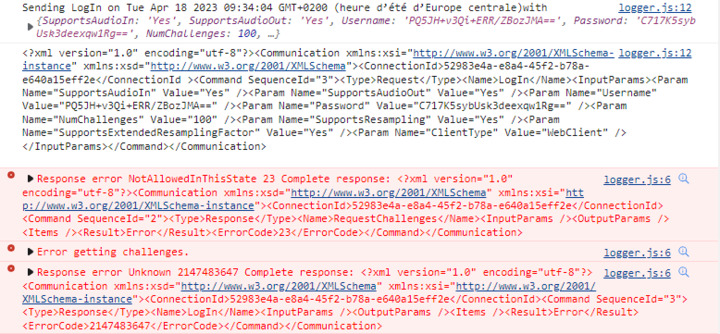

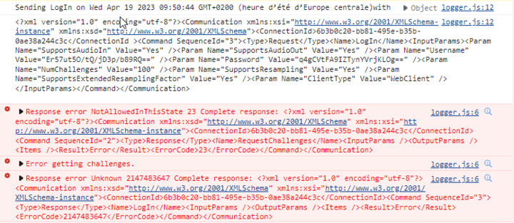

we still have the same error with a priori in the logs a login error see screenshots below.
Cordially
Logs milestone 2
there are two requests that result in the message: No challenges in the list!
then the error messages
First request
Logs milestone 3
Second request
Errors
