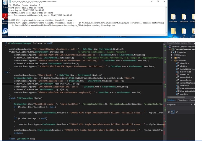

I send you the code picture and the log as your request.
The exception is on VideoOS.Platform.SDK.Environment.Login instruction.

The exception you get is most likely a ServerNotFoundMIPException - that would be thrown with no message - but the reason behind could be any kind of issue making it fail getting in contact with the server. Could you please try check
[c:\ProgramData\Milestone\MIPSDK\MIP](file:c:/ProgramData/Milestone/MIPSDK/MIP).log and see if there is anything useful in there? If not please try do a wireshark and see if that gives you any hint what is going on - if not feel free to upload it here and we will have a look.
