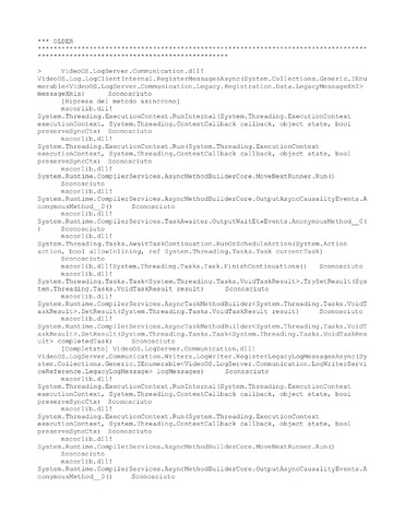

Yes, of course.
I tested 2 different plugins, the first, let’s call Older, started with SDK 2019R2 and completed with 2019R3, the second, Newer, started with 2019R3 and still not completed. I jumped 2020R1 release.
Attached you will find both stack traces.

Milestone Development will start an investigation.
Hi Frediano,
Thank you for letting us know about the issue you are encountering. We have created a bug on our backlog that we will use to track the issue, and gather the necessary information.
A bit more info background:
LogClientInternal.RegisterMessagesAsync, in the Smart Client, is the one throwing the exception. This is an issue with the SC termination process and has nothing to do with the plug-in you are developing. It happens fairly randomly and depends on the order of things being cleaned up.
