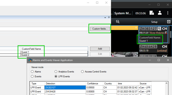

Here a Screenshot:
Uper left: Management Client
Uper right: SmartClient
Lower right: Alarm & Event Sample
It is not appeared automatically, you will need to utilize and display this field in your plugin. Please check the sample code, there is a method called loadClientLPR () line 166 around in MainForm.cs. in the method, you will see each event’s detail in foreach loop and that has the custom field. That is what you need to use and show in your plugin.

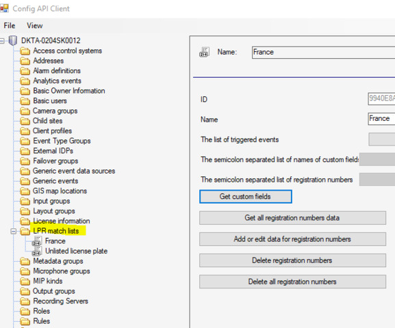

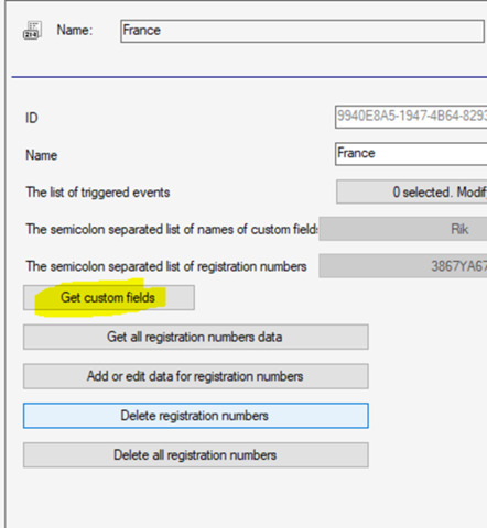

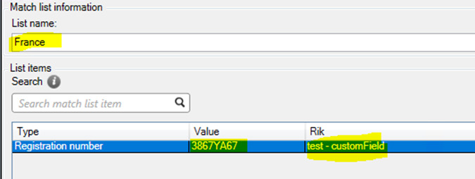

I am very sorry, we realized that this is a bit complicated, and we tested the sample and found that we could not see the custom filed in that sample. Our previous post was wrong. Instead of the sample, the custom field can be seen in ConfigAPI Client sample, please see link - https://doc.developer.milestonesys.com/html/index.html?base=samples/componentsamples/configapiclient/readme.html&tree=tree_2.html.
Please see following instructions.
Set up a custom field on Management Client.
Run the ConfigAPI Client sample.
Select LPR match list (we used “France” list in our test.)
Click “Get custom fields”.
Input registration number and click Get custom Fields. Then, you will get the custom Field.
