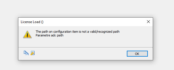

Firstly fire this error : Licence Load
Details:
The path on configuration item is not a valid/recognized path
path (VideoOS.Platform)
Program location:
at VideoOS.Platform.ConfigurationItems.IConfigurationChildItem..ctor(ServerId serverId, String path)
at VideoOS.Platform.ConfigurationItems.MIPItemFolder..ctor(ServerId serverId, String path)
at VideoOS.Platform.Configuration.GetItemConfigurationBase(ServerId serverId, Guid itemKind, Guid objectId)
at VideoOS.Platform.Configuration.GetItemConfiguration(Guid pluginDefinitionId, Guid itemKind, Guid objectId)
at VideoOS.Platform.License.LicenseManager.LoadLicenseInformation()
path (mscorlib)
Program location:
Server stack trace:
at System.ServiceModel.Channels.ServiceChannel.HandleReply(ProxyOperationRuntime operation, ProxyRpc& rpc)
at System.ServiceModel.Channels.ServiceChannel.Call(String action, Boolean oneway, ProxyOperationRuntime operation, Object[] ins, Object[] outs, TimeSpan timeout)
at System.ServiceModel.Channels.ServiceChannelProxy.InvokeService(IMethodCallMessage methodCall, ProxyOperationRuntime operation)
at System.ServiceModel.Channels.ServiceChannelProxy.Invoke(IMessage message)
Exception rethrown at [0]:
at System.Runtime.Remoting.Proxies.RealProxy.HandleReturnMessage(IMessage reqMsg, IMessage retMsg)
at System.Runtime.Remoting.Proxies.RealProxy.PrivateInvoke(MessageData& msgData, Int32 type)
at VideoOS.ConfigurationApi.ClientService.IConfigurationService.GetItem(String path)
at VideoOS.Platform.Proxy.ConfigApi.ConfigurationServiceClientDecorator.<>c__DisplayClass3_0.b__0(ConfigurationServiceClient client)
at VideoOS.Platform.Proxy.ConfigApi.ConfigurationServiceClientDecorator.CallWithRetry[TResult](Func`2 call)
at VideoOS.Platform.Proxy.ConfigApi.ConfigurationServiceClientDecorator.GetItem(String path)
at VideoOS.Platform.Proxy.ConfigApi.ConfigurationApiItemWrapper..ctor(ServerId serverId, String path)

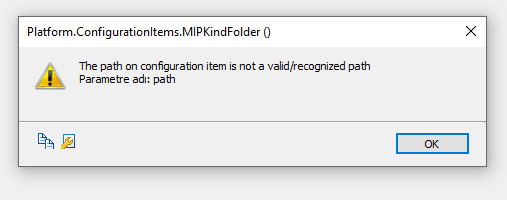

Second error MIPKindFolder
Details:
Program location:
at VideoOS.Platform.ConfigurationItems.MIPKindFolder..ctor(ServerId serverId)
at VideoOS.Administration.AddIn.XPCOEnvironmentManager.FirstTimeInitializationCheck()
path (mscorlib)
Program location:
Server stack trace:
Lasly shows this error and exit app.

Hi. Can you please tell me what the plugin is when you see this error? Please let me know about it.
No plugin installed. I start the Management Client than raise an this errors.
After I had reinstall, problem fixed.
Hi, I have exactly same issue for Management Client 2019 R3 and reinstall didn’t solve my problem. What should I do?
If you remove all plugins does the issue still happen?
https://developer.milestonesys.com/s/article/MIP-SDK-plugins-remove-the-plugins-you-do-not-use
If a plugin is causing this which one?
If you have no plugins please ask again in the support community, in that case you should get better help from the partners using the support community.
PS. Please help us keep the Developer Forum readable and searchable, please ask a new question rather than appending to an old one..
