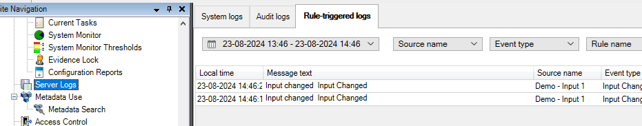

I have an idea that you can test in an alternative way. Create a rule that will write to log when an input is changed. See the log if there are the expected entries in the log.
On the other hand, I don’t know what will happen to the log if you log 10000+ in few milliseconds.
