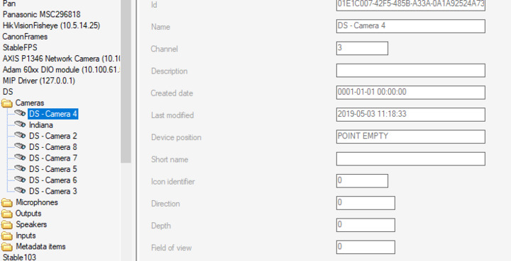

The Management Client actually order cameras on the same hardware alphabetically..
Whereas the order as seen in Config API Client sample is pseudo-random starting with number 4
You can implement your own ordering and base it on the “channel” property. (You also see that property in the picture above).
