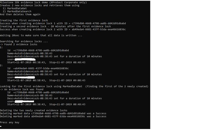

Evidence sample output should look like:
I could able to get the newly created evidence locks after increasing sleep time from 20 sec to 60 sec. why does it takes such a huge time to update database?
