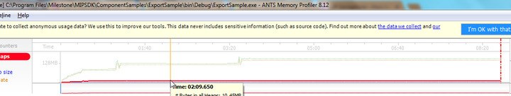

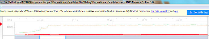

I am exporting videos into mkv format and I use MKVExporter for this . I got the camera search mechanism from CameraStreamResolution sample and export mechanism from Export Sample. The generation happens successfully but I see that the memory is not getting released after each export. So I decided to check the memory footprint of the SDK samples as well.
The above screenshots are the memory footprints of CameraStreamResolution(1st graph) and Export sample(2nd graph) using Ants where you can see that the memory is not released.
Yes, the export sample graph is for two exports and both times the memory is not released.
