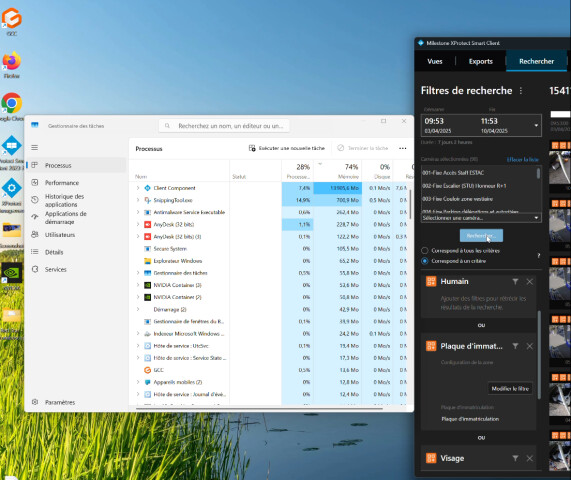

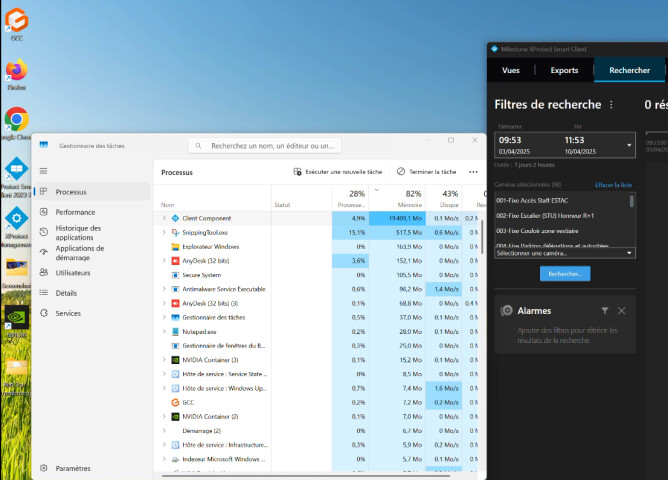

I’d like to share my finding on a customer site, which would be related to a memory leak. The reproduction steps are as follows:
  1. Search by a motion filter
  2. After completing the search, search by multiple custom filters which are using any or and criterion search
  3. While searching, invoke a new search by milestone alarm filter which is intended to find no result at all
Even after completing the alarm search with no search results, the memory keeps increasing up to 20GB and the memory was not cleared until closing the smart client.
