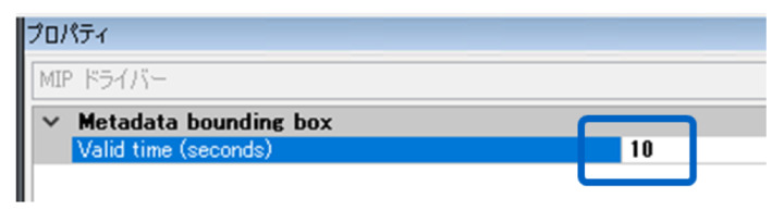

According to this change, we set Valid time of metadata to 10 sec. with Management Client.

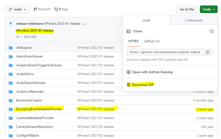

Can you please tell us which version of VMS are you using when you see the issue? Also, please verify that you are using the newest samples (https://github.com/milestonesys ) and Nuget (https://www.nuget.org/packages?q=milestone+systems )

We cannot reproduce the issue using 2023 R1 VMS(Corporate) and the newest sample.
We are using XProtect Professional+ 2022 R1.

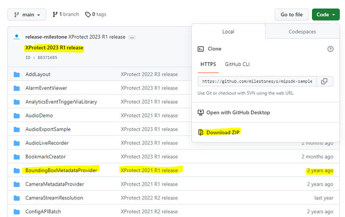

We got the Bounding Box Metadata Provider sample from github recently by clicking “Download ZIP” button.
We think this sample is the newest because the Bounding Box Metadata Provider has not been updated for 2 years.

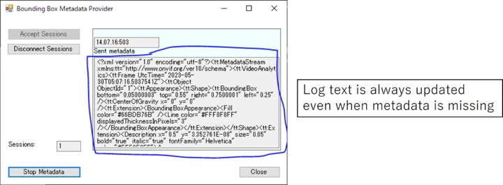

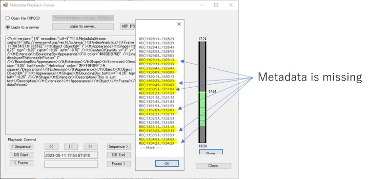

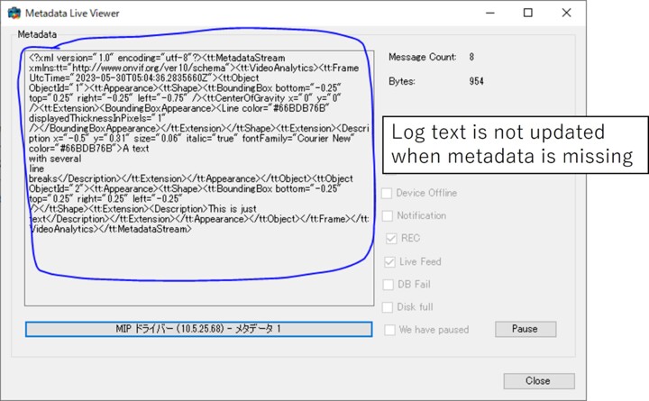

We tried MetadataPlaybackViewer and confirmed that metadata are missing in the playback data.
We tried MetadataLiveViewer as well.
The log text on the window was not updated when this issue occurred.
For you information.
The log text on the BoundingBoxProvider is updated correctly even when this issue occurs.
We assume that there is no problem in queuing metadata of BoundingBoxProvider.

2)We set Valid time of metadata to 10 sec. with Management Client. Please check it as well.

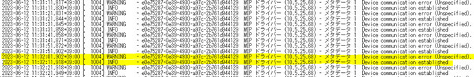

Log path is here - [C:\ProgramData\Milestone\XProtect](file:C:/ProgramData/Milestone/XProtect) Recording Server\Logs
DeviceHandling.log, DeviceFeedState.log, ImageServer.log might be good to check.
Please check logs there and find log entries that fit for the issue.

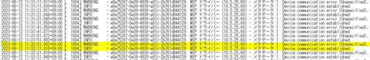

I confirmed the log files you mentioned.
-DeviceHandling.log
There are a a lot of warning and info messages in DeviceHandling.log.
The lines written in yellow are the messages at the timing of missing metadata.
Is this expected behavior?
-DeviceFeedState.log
There are no messages on this log file.
-ImageServer.log
We found the following warning message near the timing of the problem.
Is this relavant to the problem?
2023-06-12 11:08:47.219+09:00 [ 1257] WARNING - HandleConnect: Timeout getting a mediaFeedHandler from the device

Are there any errors (not warning) in the logs?
These warnings are fine, because the log entries show us Established as info after the warnings. So to my knowledge, that is not the issue.
There are no errors in the log files.
