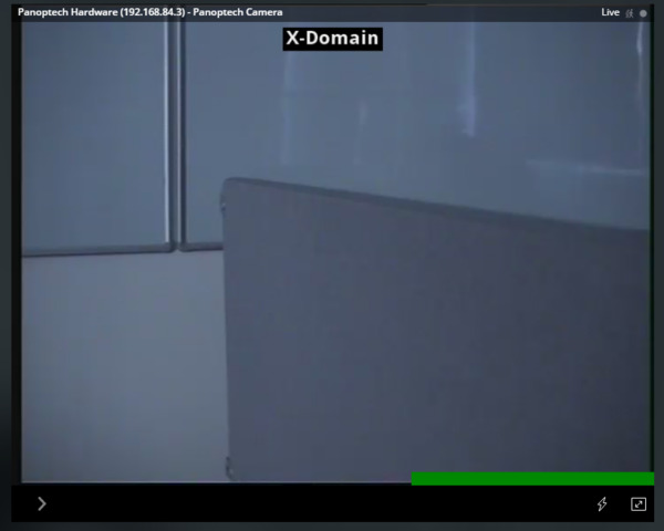

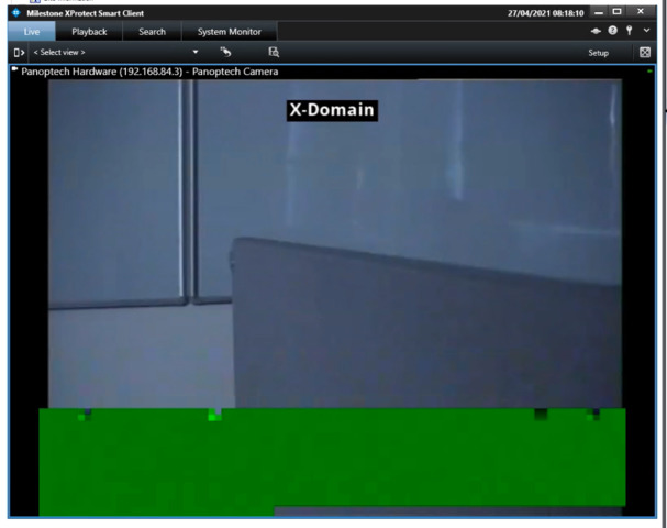

We’re still stuck on this, some more clarity as to what this error means would be greatly appreciated: Panoptech Camera Unable to add one or more frames to the frame collector (Logged only once a minute). Error code = 5
I see two problems with your implementation.
One is that you have no lock around your data so the receiving code might update some of the variables while the sending code is reading them. (made even worse from the face that you don’t copy the data variable, but just assign a reference)
The other is that if data comes in slightly irregular it might mean that a frame is overwritten by the receiving code before the sending code get to pass it on. I would suggest introducing a queue for the transfer, so that the receiver adds header+data to the queue and the sender takes it from there.
Still getting Unable to add one or more frames to the frame collector (Logged only once a minute). Error code = 5 errors.

Hi - good news! We’re now getting video into Milestone which we’re excited about, thank you for all your help on that.
Some bad news however, we’re getting some frame pixelation, distortion? Not sure on the correct terminology. This distortion only happens within the Smart Client. It looks as though it has old pframes being loaded into the image that we’re currently looking at.
In the Management Client preview window under your devices, it appears correctly with none of the same issues and notably when exported from Smart Client to an AVI format - none of this distortion exists either.
We’ve also noticed the first time you start the camera (or if you view the camera in the web client), there are a lot of green bars that appear in the same sort of place where this distortion occurs as well.
Is it possible that I’m not loading the pframes fast enough for live video, but its sufficient for saved/exported video?
Any advice would be appreciated. Screenshots with examples of what’s happening below.
Thanks,
Patrick
Example of the same video at the same time showing the issue in Smart Client and not in Management Client
example-milestone
Example of green bars in Smart Client (only appears at load)
Example of green bars in Web Client (continues to appear all the way through watching)
Hi Patrick
This sounds pretty strange. Could you please check whether this also happen in playback (browse) mode in the Smart Client?
And also try enabling the Video Diagnostics Overlay level 3 in Smart Client under Settings → Advanced and then watch whether frames are dropped or similar.
