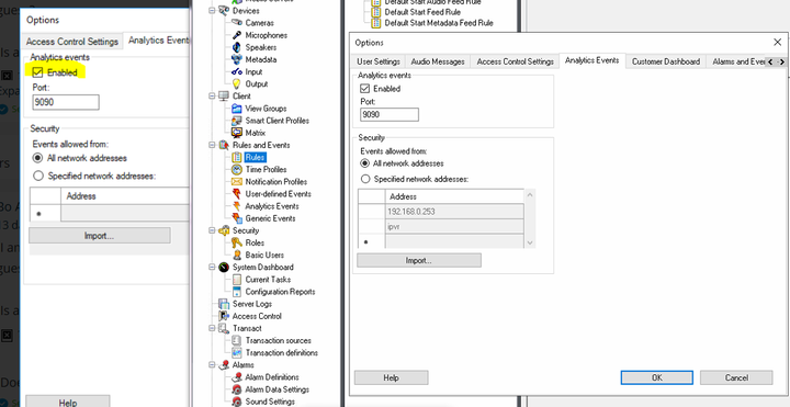

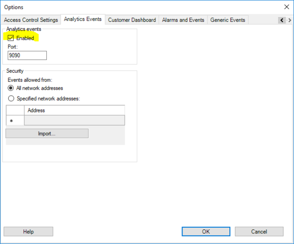

Yes, the analytics events was enabled and of cause the Event Server is running.

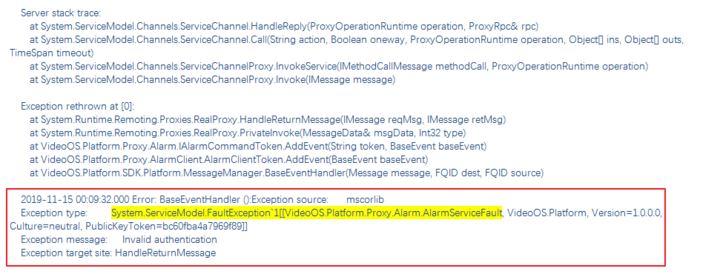

After log analysis, the plug-in normally sends data to Milestone, but the MIP interface has an internal processing exception. The exception is as attached file “Exception type”. It seems that the AlarmService authentication failed.
Thanks.
Exception rethrown at [0]:
at System.Runtime.Remoting.Proxies.RealProxy.HandleReturnMessage(IMessage reqMsg, IMessage retMsg)
at System.Runtime.Remoting.Proxies.RealProxy.PrivateInvoke(MessageData& msgData, Int32 type)
at VideoOS.Platform.Proxy.Alarm.IAlarmCommandToken.AddEvent(String token, BaseEvent baseEvent)
at VideoOS.Platform.Proxy.AlarmClient.AlarmClientToken.AddEvent(BaseEvent baseEvent)
at VideoOS.Platform.SDK.Platform.MessageManager.BaseEventHandler(Message message, FQID dest, FQID source)

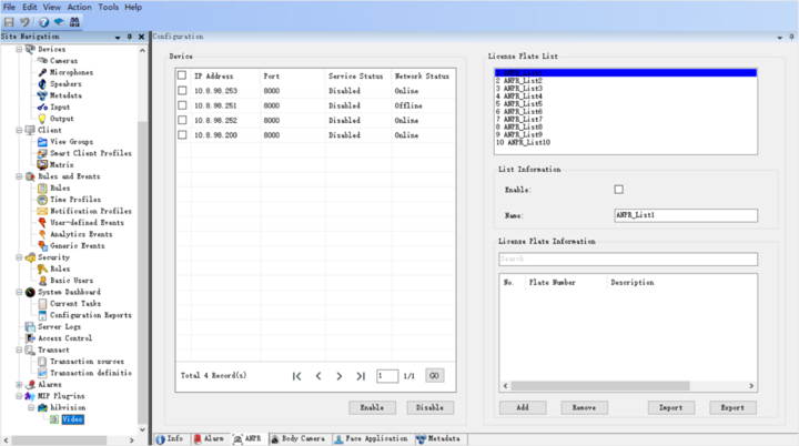

Hi Dear friend, yes, we developed the HIKVISION plugin service based on the MIP SDK. Currently, we suwpect the compatibility may changed between the 2019 R2/R3 MIP SDK with the previous version. it may causing problems with the alarm module between HIK plugin and Milestone 2019 R2. But we not able to ensure it.
