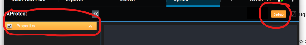

I’m trying to develop a MIP plugin integration for Smart Client and it appears I need to add some configuration items as Plugins properties (check the screenshot provided)
Considering I want to use some URLs inside my plugin, I should be able to Add/Edit/Save them using this “Setup” Properties option. Those customizable items should be listed under this as editable text boxes.
Is it possible to do this? if so, any suggestions on a recommended way to do this?
