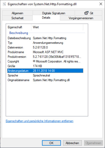

I see, that 23.2.1 uses Microsoft.AspNet.WebApi.Client and Microsoft.AspNet.WebApi.Core in the versions 5.2.7, which I’d updated to 5.2.9. Otherwise I’ll get while compiling:
