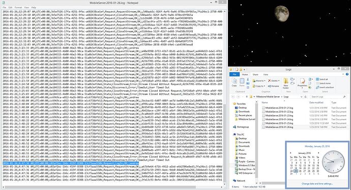

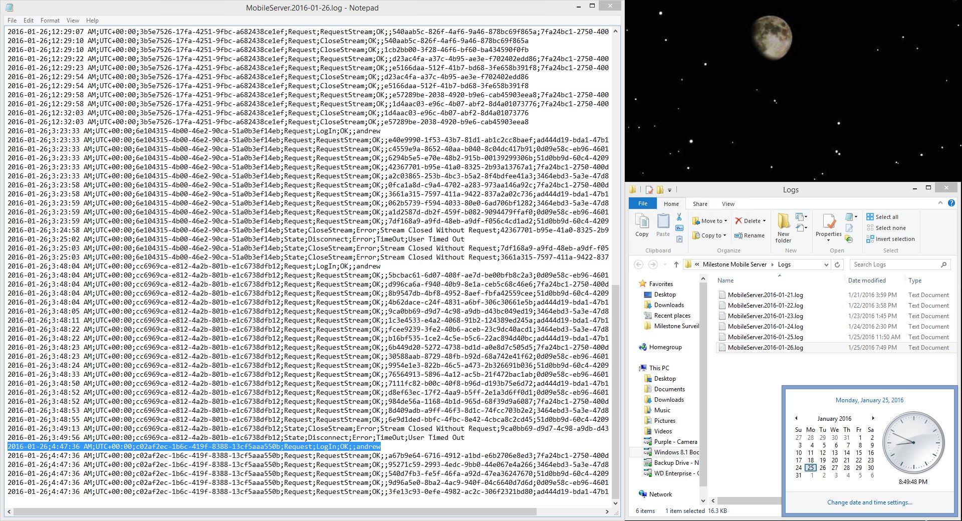

Hello, Since I updated to xprotect go 2016, the mobile server daily log(s) have each entry with the incorrect hour and minute, and entries are posted 1 day in advance. The system time is correct in windows and the BIOS, as well as the time on cameras and in the management application and smart client. Is this a bug? Or how can I adjust the time parameters for the mobile server logs? Thank you.

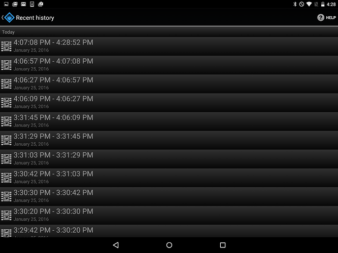

I am also scratching my head at this, since having used the software for years and never seen this before. The time is correct on the mobile applications for “recent history” list and live view as well as the mobile devices system time. All connections are being used in the same time zone. Attached picture shows a login event highlighted with the log time and the actual real time.

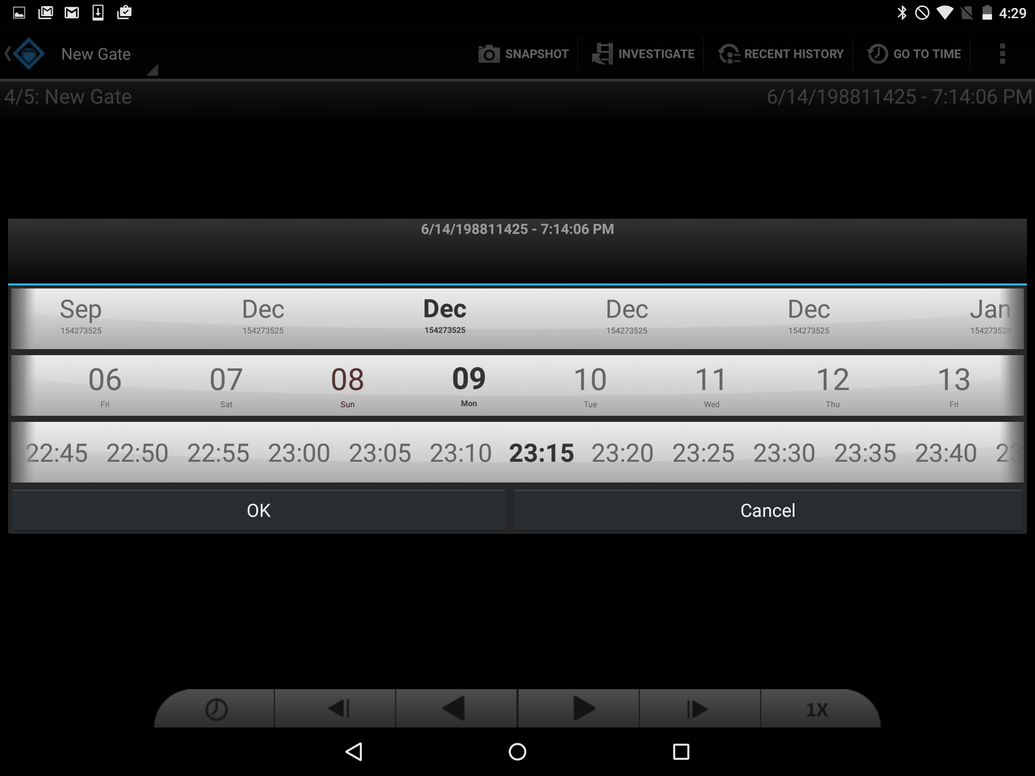

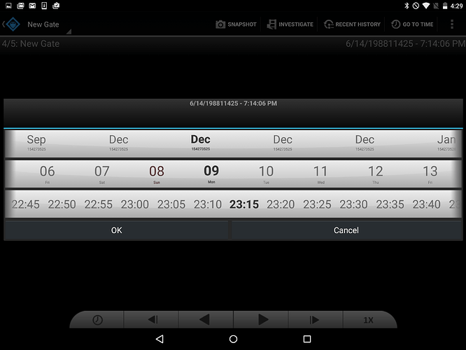

Also…I am not sure if this is related or not, but just on my android device, Milestone Mobile (Installed on a Nexus 9 OS 5.1.1; Milestone mobile app version 10.0) will not allow me to select a date or “Go To Time”, without listing a year to pick from, such as as year (varies) 154273525. Yes, I know this is year 2016 not 154273525. Playback from recent history does not load but rather tries to load a date from many thousand years from now. [for example, I wanted to load a time event from 3:10:27 on 4-25-2016, the preview is of the last most recent still frame, and the date and time on the app says 7/12/123028584 at 9:12:41AM.]
