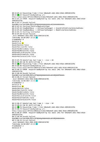

The plot actually thickens here, because the decoded frame timestamp does not match the request time. It wouldn’t be an exaggeration to say that it can take 10-20 seconds to return the first good frame (after which it generally continues as it should). I’m attaching another log - this time just the frame requests/responses - where I’ve added timestamps to the logger. Ignoring the time difference (+1hr timezone and a few seconds) between the client and server clocks, you can clearly see that the 10 frames are requested over a period of approx 5 seconds and yet the decoded timestamps are all the same - and still it doesn’t return a good frame. And before you ask, yes, I do clear my response object before sending the request (and can see the behaviour mirrored in fiddler). Notice also that the header size changes between frames 4 & 5.

Time between request is about 700 ms (seems too big to me).
Does the behavior changes if you try to ask for frames more frequently ?
Another thing - many responses are received with HeaderSize of 44. Having in mind that Main header size usually is 36 bytes (rarely 40), this means there are 8 additional bytes. Which passes with size of the LiveInfo header extension. But on the other hand HeaderHasLiveInfo is set to False. This doesn’t make sense.

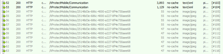

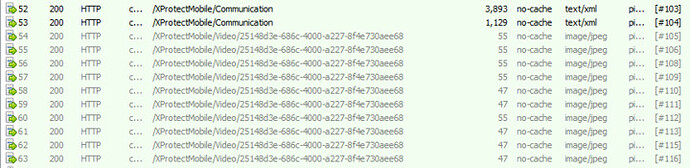

I can’t upload a fiddler log as it may contain sensitive information. I’m assuming you work for Milestone, but it’s not clear from your profile. I could probably encrypt it and send to a milestone email account. In the meantime, I have attached a sanitised screen grab showing an example data flow (though not the one from my debug logs). In the screen shot you can clearly see the different packet sizes
