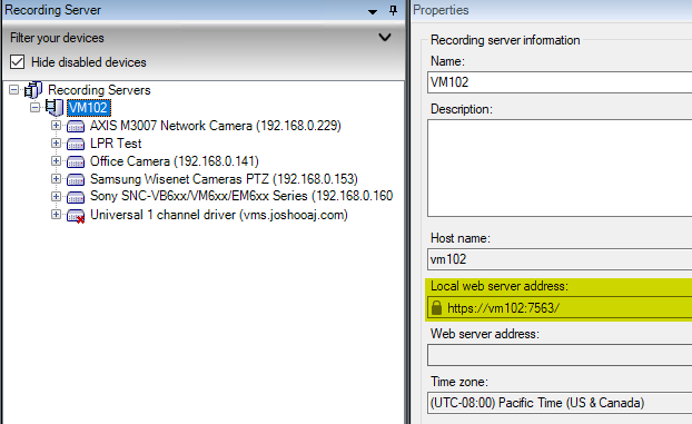

Thank you very much Josh for the response(and the youtube shoutout). It was very helpful and exactly what we needed. We were able to get the SD card response. We do have a question regarding the PSTool’s Send-MipMessage function. When we call Send-MipMessage inside of Send-VmsDriverCommand from a remote machine. The public endpoint gets forwarded to the local hostname for the recording server on the milestone machine, which causes an error - "DriverCommand returned an error: ERROR: -2146233087: There was no endpoint listening at
http://win-1234:7563/recordercommandservice/recordercommandservice.asmx that could accept the message." We can temporarily solve this by rerouting the win-1234 domain to the public address, but this is not ideal. Looking at the docs for Send-MipMessage there is no way to specify an address for the recordercommandservice endpoint. Is there a way around this?

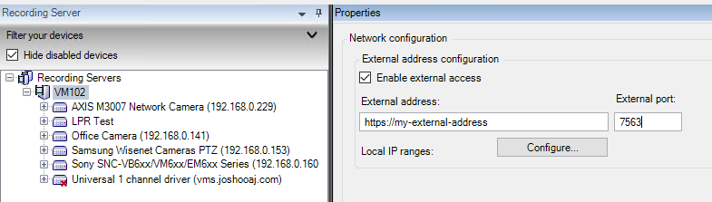

Hmm, I would expect that the connection would be made to whatever address is reported as the local web server address for the recording server in Management Client. That address is the hostname or FQDN of the recording server by default, but can be modified in the RecorderConfig.xml file on the recording server under “[C:\ProgramData\Milestone\XProtect](file:C:/ProgramData/Milestone/XProtect) Recording Server\” by editing the “host” node under “webserver” like the screenshot below.
If you have external access enabled on the recording server, then that address should be used if the system running PowerShell is connecting from an IP address the management server doesn’t recognize as “local” which includes all subnets for enabled NICs on the management server and any manually entered ranges in the Tools > Options dialog in Management Client.
