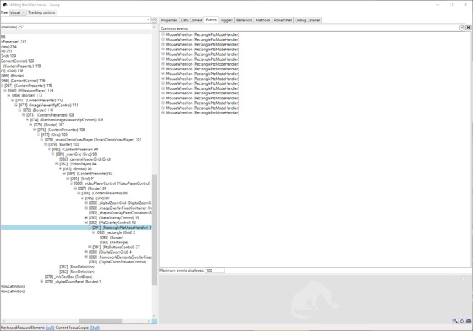

I have used snoop to verify that the mouse wheel events are propagated to the image viewer. What have I missed? I have compared with the ImageViewerClient sample project and I think I set up the player the right way.

I have now compared the MouseWheel event on ImageViewerWpfControl between my application and the ImageViewerClient-sample. I see that in my application I get a RectanglePtzModeHandler as the OriginalSource and in the sample I get a PtzOverlayControl. Maybe this is the reason why mousewheel digitalzoom is not working. Any ideas why OriginalSource differs?
