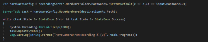

Hello I’m using Milestone 2018 and 2020 SDK to move hardware between RecordingServers. When I Invoke de method hardware.MoveHardware(RsPath) the server task respond Success but when I search de hardware inside de Management Client, the hardware hasn’t been moved
This is de implementation, the path is from the Destination RercordingServer

Yes I saw it, is using the wizard when i click the button, but my method execute in background and Im using the method available in the hardware. First i find de hardware by Id, then y try to Move it passing the path of the restination RS
What I am asking and hoping you can test. If you use the Config API Client to do the hardware move does it fail in the same way as it does when you use your code? (Does it work or fail from the sample?)
From the sample is working fine but is using the configurationService. But from the SDK not. I also made an SDK upgrade to version 2023 and the method MoveHardware response is success but the hardware does not move when I refresh the management, what im doing wrong in my code?

Where your code ends the servertask is in “InvokeInfo” which is a mechanism where additional information is requested.
Please try our this piece of code that works for me. (The code is sort of a hack, how I find the objects to manipulate or use, but I hope as an example you will not mind that.)

Now is woking with SDK 2023 and this example, i did not know that i must set DestinationStorage Property before executing task. I made the test with SDK 2020 but the task doesn’t have the method executeDefault. Can you give me an example with SDK 2020? , because i had multiple proyects with different SDK versions
