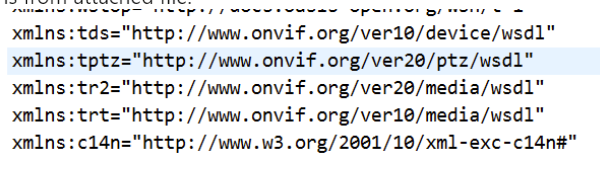

From the made investigation I have found that you have missing namespaces in your GetServicesResponse scheme.
Both of the namespaces going together in order successfully to continue with setting up media2 service.
In the Wireshark trace I see you have the 2nd, but 1st is missed:
Picture is from attached file:

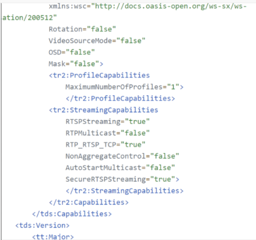

Also, most of the capabilities in GetServicesResponse are set to “false”, which can cause problems as well:
