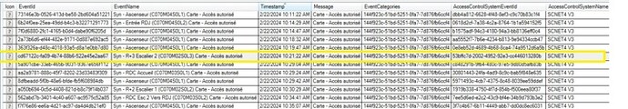

We can see that though events are not recorded or transmitted twice by the access control system to its client interfaces, a few minutes after the first occurrence of an event recorded in Milestone XProtect, it seems to appear a second time both in the Smart Client and the Management Client. The Management client shows a different UID for the recorded event.

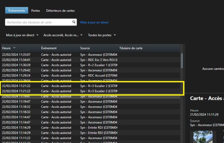

I checked this issue again this morning on the customer site and had both the Smart Client and the Management open.
I can observe that:
A single occurrence shows in the live event tabs of the management client window
But then, on the events displayed in the Smart Client interface, the same event seems to appear twice: (I redacted out the names of the users of the system appearing in the access control events).
Do you have any idea how that might happen ?
