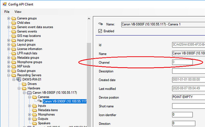

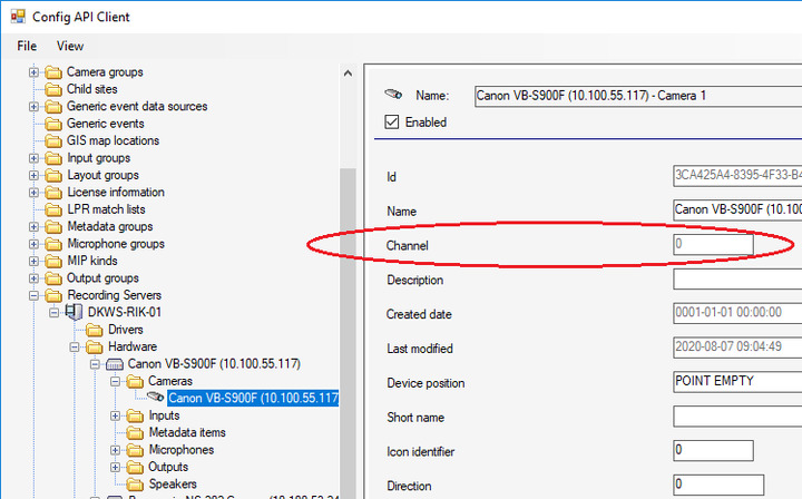

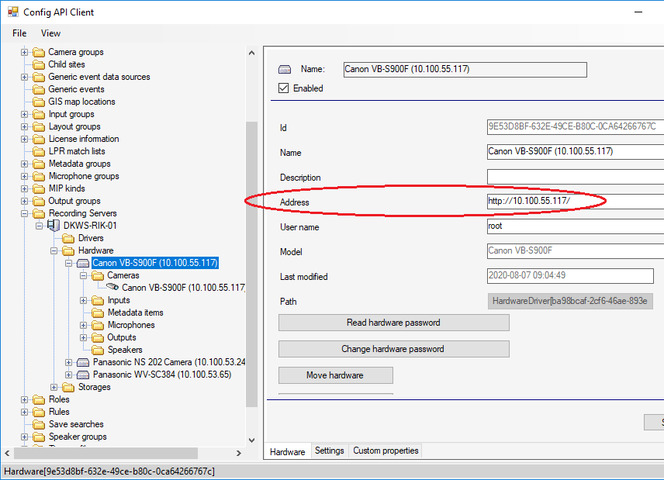

First, please start Config API Client sample. Click Recording Servers – Hardware – (your target hardware), then you will be able to see Address. Also click Cameras - (your target camera) then you will see channel.

Please see following code, it indicates how to get Address and Channel via Configuration API strongly typed classes.
// This is the regular Item of the camera as supported by the Configuration class, you probably have this “Item” already
VideoOS.Platform.Item cameraitem = Configuration.Instance.GetItem(new Guid("3CA425A4-8395-4F33-B411-7B5FF0C8AC9A"), Kind.Camera);
// This is the camera item as supported by the strongly typed configuration API
// using VideoOS.Platform.ConfigurationItems
Camera camera = new Camera(cameraitem.FQID);
var channel = camera.Channel;   // Get channel
Hardware hardware = new Hardware(EnvironmentManager.Instance.CurrentSite.ServerId, camera.ParentItemPath);
var IPAdress = hardware.Address;    // Get IP address
