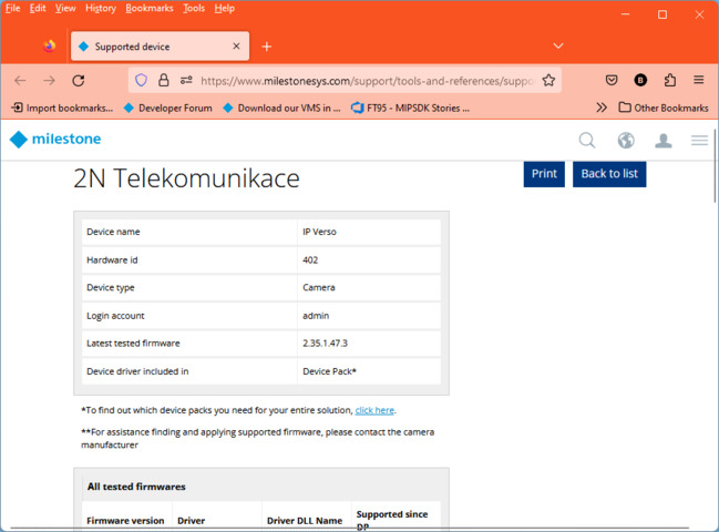

There is a database like the one you ask for!
I did not think to include it before because it is outside the domain of the SDK.
You find it here: https://www.milestonesys.com/support/tools-and-references/supported-devices/
Once you have found your camera using make and model just click on the device in the list and open details. In the details you see as field #2 the “Hardware id”.
Here is an example (semi-random, one of the first cameras in the list):
https://www.milestonesys.com/support/tools-and-references/supported-devices/supported-device/?deviceId=41504&platform=XPCO&backCloses=true
