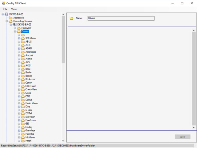

this is a very good app and we are reviewing it. However, is there a way to get a list of all the device driver hardware ids? we can’t expect our customer to have to go to the webpage to get this data. could we get it as a csv or some kid of file that we could parse and use when adding cameras?
thanks,
The list of drivers are also part of the Configuration API.
If you see the Config API Client you find it as illustrated:
Note: The ConfigAddCameras sample is today a sample included in the MIP SDK. - http://doc.developer.milestonesys.com/html/index.html?base=samples/configaddcameras.html&tree=tree_2.html
