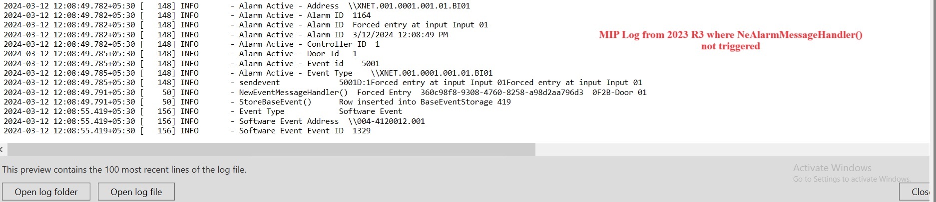

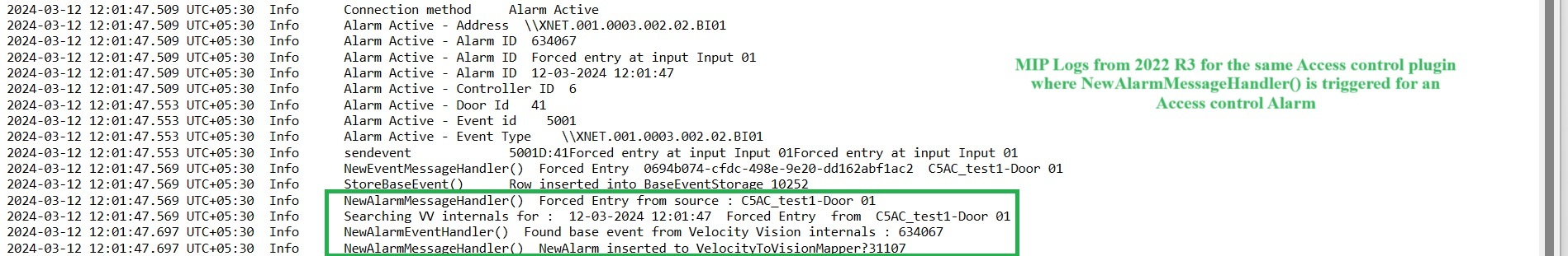

I have written an access control plugin which works perfectly fine on 2022 R3. When it came to 2023 R3 there were issues regarding alarmclient. When the latest patch was applied it sorted out few issues, but one issue is still persisting. If we take the 2022R3 logs , we could see on the highlight that NewAlarmMessageHandler() has been invoked.

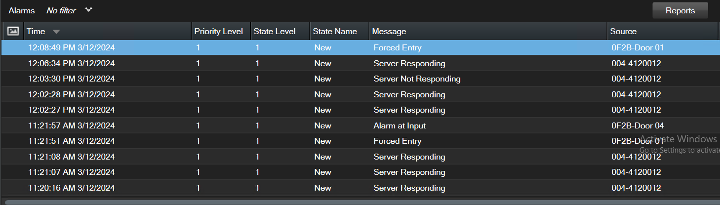

But when the same plugin is installed on 2023 R3 it doesnt invoke th NewAlarmMessageHandler() even after the latest patch installation which claims to fix the issue with alarmclient. This leaves the plugin unusable on 2023 R3. The below log shows no signs of NewAlarmMessageHandler being invoked even though the alarm is visible on Alarm Manager on Smart client.
