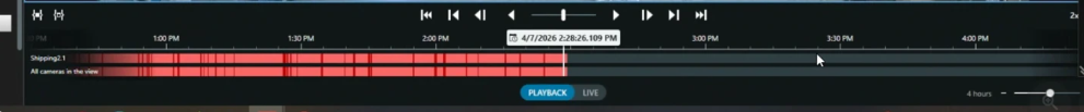

I understand that you use the Web Client to see the footage that was recorded. The Web Client has a time line bar that is red when there is recording. If that bar is empty I would guess that there is the same issue happening. Please share how the the time-line bar looks in a client.

Yes here is the image of the recordings timeline on the web. It seems as there are no pauses or repairs in the recordings.
