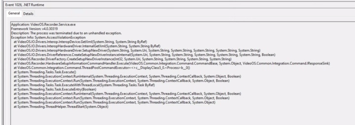

I’ll attach the logs to this. Also, I noticed in the Windows Event Viewer this error every time we tried the Replace Hardware SDK call. I believe we were attempting to change from 81 to 94 channels at the time we received the first error. (We had been adding channels, usually around 16 at a time, up until then just fine). In the more recent entries in the log, I had tried deleting the hardware device from the recording server and re-adding the hardware, but the effect seemed to be the same (“no response from recording server”)
