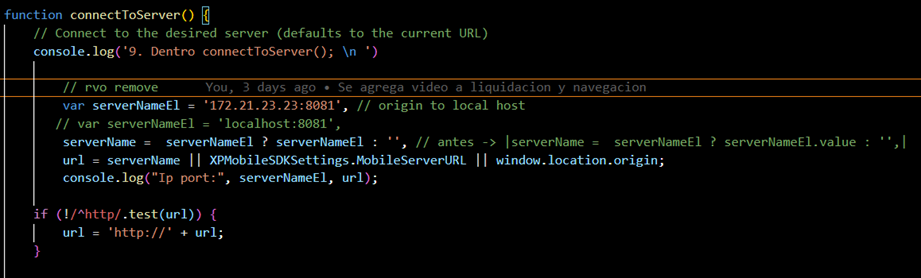

In this case the address, because it was not clear what it should be, was tested with the following configurations:
172.21.23.23 - IP of BD
172.21.23.20 - IP of node 1
172.21.23.24 - data_collector IP
172.21.23.22 - virtual IP of the cluster

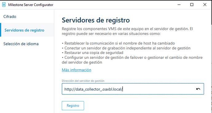

data_collertor_.oaxbl.local - address given by the Milestone Server Configurator
The Milestone Server Configurator provides this configuration:
In this way the js is being integrated to obtain the video.
However, when entering the function, it gives us this error.
