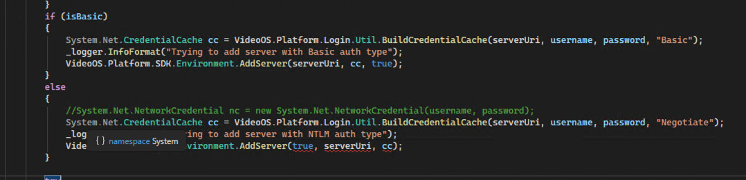

   if (isBasic)
    System.Net.CredentialCache cc = VideoOS.Platform.Login.Util.BuildCredentialCache(serverUri, username, password, "Basic");
    \_logger.InfoFormat("Trying to add server with Basic auth type");
    VideoOS.Platform.SDK.Environment.AddServer(serverUri, cc, true);
  else
    System.Net.NetworkCredential nc = new System.Net.NetworkCredential(username, password);
    \_logger.InfoFormat("Trying to add server with NTLM auth type");
    VideoOS.Platform.SDK.Environment.AddServer(serverUri, nc, true);
  try
    \_logger.InfoFormat("Trying to login server: {0} with user: {1}", serverUri.ToString(), username);
    VideoOS.Platform.SDK.Environment.Login(serverUri, true);

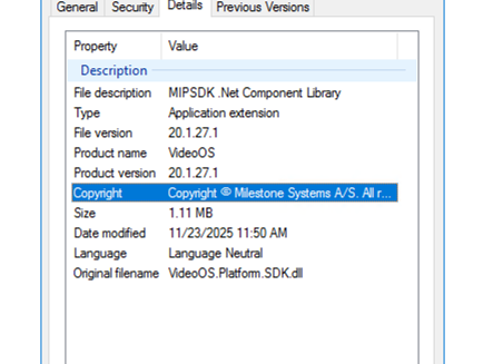

as i wrote we are using an old sdk, this is the dll file, i can see the sdk version is 20.1.27.1, the xprotect is with version 2025 r2
and also you can see its trying first to port 80 and then tries https
Actually you wrote that you had switched to MIP SDK 2025 R2 (25.2a). If you try the sample I mention unmodified (which will use the newest MIP SDK) do you see an issue?
sorry my bad, if by saying the sample you mentioned you mean to try using the VideoOS.Platform.Login.Util.BuildCredentialCache also for the windows user, so yes i tried and still same issue

I can see the login in the Camera Stream Resolution sample is slightly different, using Util.BuildCredentialCache also for Windows user. Could you try the sample unmodified? Does it login or do you see the same issue? (Alternatively try to modify your code to follow the sample.)
https://doc.developer.milestonesys.com/mipsdk/index.html?base=samples%2FComponentSamples%2FCameraStreamResolution%2FREADME.html&tree=tree_2.html

i tried to use the sample you provided me but my sdk version not recognizing the addServer method with those parametes
My intention was to know if the new MIP SDK solves the issue. Please note that the MIP SDK 20.1, is so old that it is no longer supported. Using the newest MIP SDK is strongly recommended.
