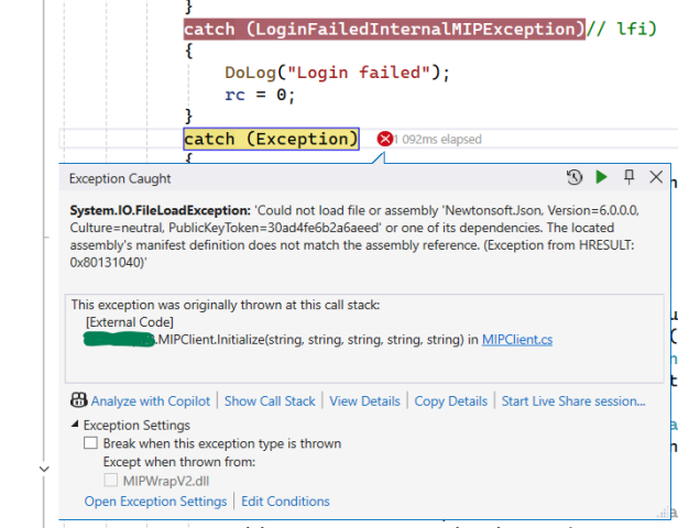

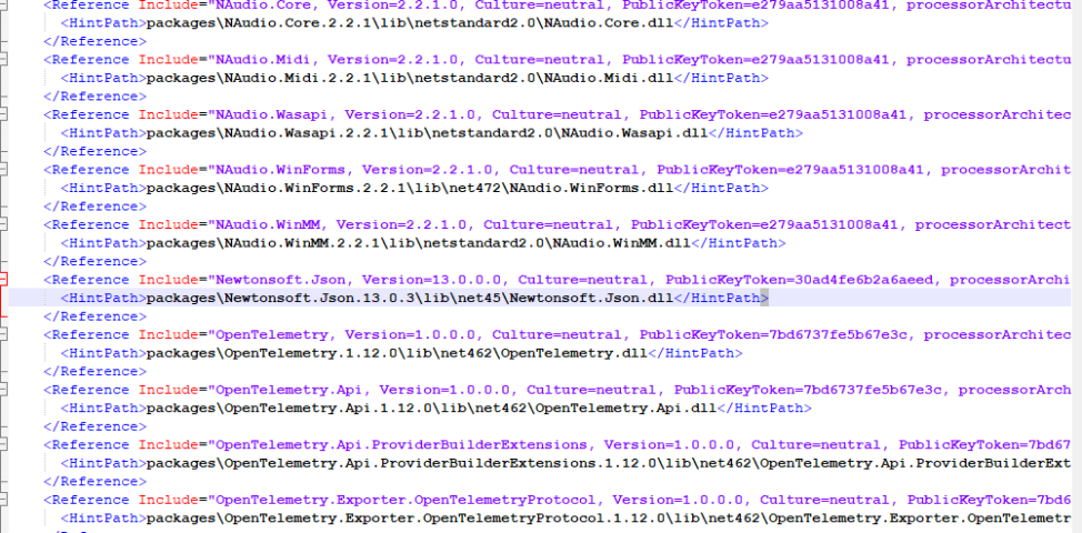

Thank you for your response. Now, I am using Milestonsystems.VideoOS.Platform.SDK version 25.3.1. Both the .cproj file and the app configuration file are set to version 13 for Newtonsoft.json package. However, the system is attempting to use version 6, resulting in a runtime exception occurring after the following line:
VideoOS.Platform.SDK.Environment.Login(uri, integrationId, integrationName, version, manufacturerName, false);
Could you please advise on how to resolve this version mismatch?

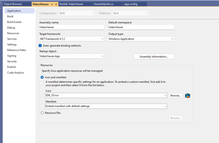

We can easily reproduce by removing the re-direct, and fix again by reintroducing it. I hope you verified you have it in the executing assembly (not somewhere else).
You could try to enable “Autogenerate binding redirects.”
Hi,
It has already been enabled. Yes, I have tried that, but I’m still getting the same error.

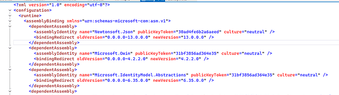

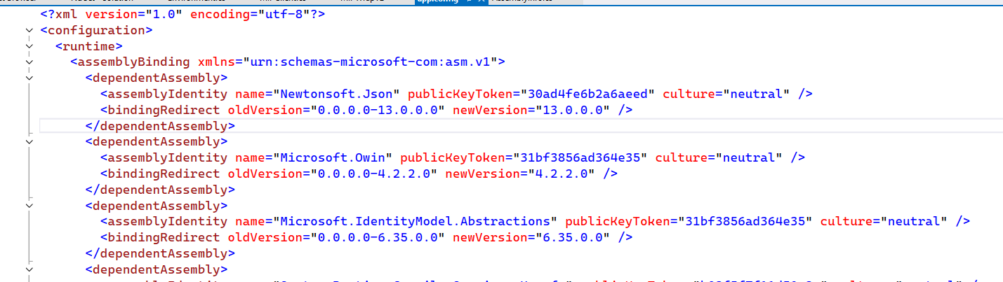

Could you verify that the assembly redirect is actually added in the executing assembly?
Hi,
Yes, the assembly binding redirect for Newtonsoft.Json version 13 has been added. Here you can see the app.cofig file:

The picture you added states MIPWrapV2 and is set to output type class library. This means it is not the executing assembly. The binding redirect have to be in the app.config of the executing assembly, this means in which ever project which creates an .exe file (at least in most cases it is an exe file)
Hi Henrik,
We have developed a custom DLL, MIPWrapV2, for our application using MIPSDK 2025 R3. The application is debugged in conjunction with some external program, Dea.exe, which was developed by RadStudio using C++. I have copied all the MIPWrapV2 DLLs into the Dea.exe application’s debug folder.
We have been using this setup since 2019 without any issues. However, I believe the problem has arisen with this year’s versions, specifically after adding the Newtonsoft.Json package.
That could very well be. I’m not a C++ developer, but I would expect that to have the C# assembly redirect working when the application is executed from a C++ application, you need to have the AssemblyResolver code you have created in the C# code.
There has to be a assembly redirect to use the latest SDK in the way you are doing.
