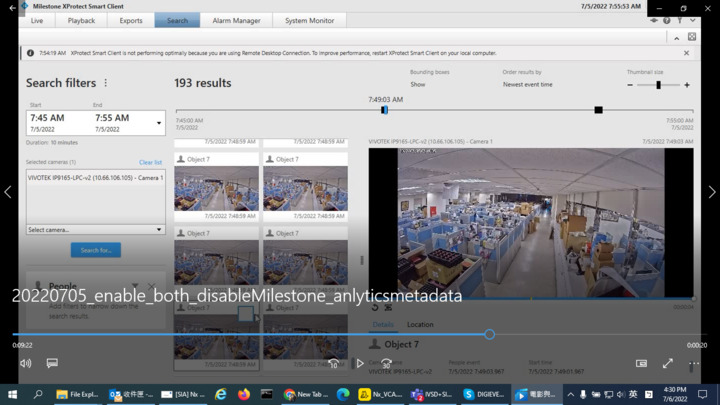

We did give ObjectID, but didn’t get the same grouping result of " If the object recognition algorithm assigns it the same id across the time period, then the Metadata Search will group all the frames in a single search result. " Actually, it shows the objectID on each frame.
