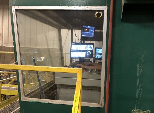

Just wondering if there is any update on this issue? I’ve attached a shot of the operator using a view with just one web-page (bottom-right). That works well but would like to show more than one page.
