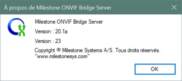

I guess placebo didn’t work in this case. I will have a closer look. Meanwhile, please share what version of Onvif and XProtect you are using. Please also try to add the xmlns="http://www.onvif.org/ver10/search/wsdl namespace to IncludedSources and RecordingInformationFilter as it is shown in the answer from the other post.
Regards,
Tsvetomira

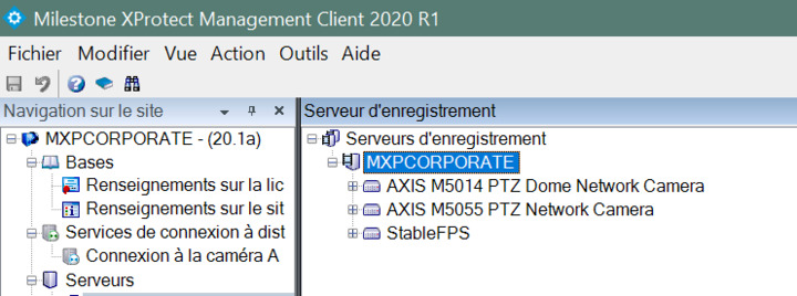

Hi Tsvetomira,
Here are some screenshots for the versions of my system.
Version3

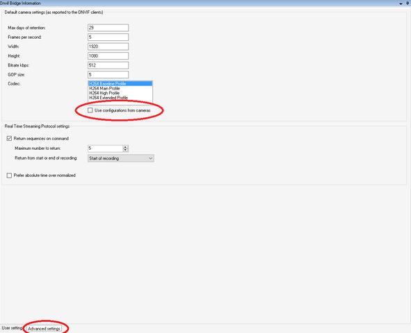

When enabling configurations from cameras, it causes the onvif bridge service to fail/stop on 2 different systems. We have seen this behavior before. If we enable this option and save changes, after 5-10 minutes the onvif service will fail.
if we disable that option, the onvif server stays stable. We have confirmed this on multiple systems as i have said.
Please advise.
The developers suspect a bug.

As I had the time to look a bit closer, I realized that Use configurations from cameras setting is not used for Find Recording, but only for GetMediaAttributes and GetRecordingSummary.
If you use Return sequences on command and get the sequences from the response of RTSP describe method, you should get pretty much stable behavior.
