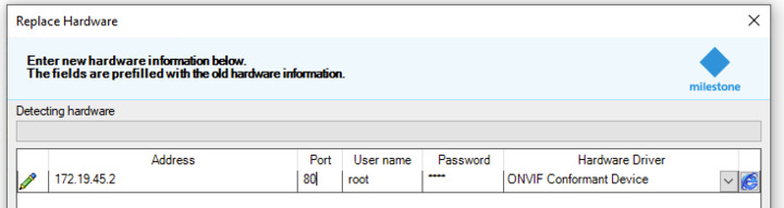

The events are defined in the GetEventProperties response, and are correctly appearing as dynamic events in the camera settings:
The issue occurs for all dynamic events we define. Both the GetEventProperties and the PullMessage responses look correct, and the device passes all corresponding tests in the ONVIF Test Tool as well. Non-dynamic events work as expected.
