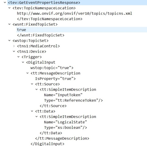

I attached our response for the GetEventProperties call.

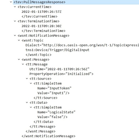

At first glance I don’t see anything wrong with GetEventProperties response that you sent. But we use the response only to get the list of events the device supports. As explained in documentation we check which of the events from the list is already supported and add as dynamic events only the rest of the events. There are also some limitation described. Then, when we receive the real event trough PullMessagesRespose we are trying to match with the description from GetEventProperties. There could be same differences that are preventing us from matching the event. To be able to help you we will need Wireshark trace. Start Wireshark capture, add the device in XProtect, configure event, activate the event on device then stop Wireshark capture save it and send it to us for investigation.

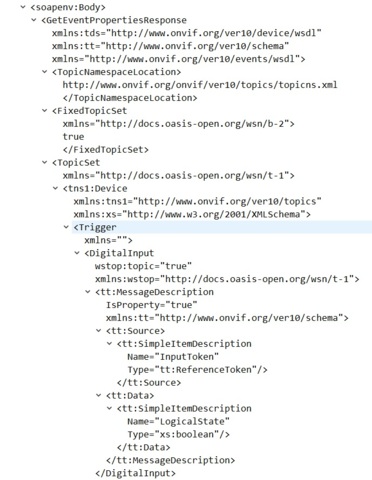

The main reason for the events not working is the missing of most of the namespaces required by standard. Not only in response of requests related to events but in all responses. Hera are example for events:
EventWithMissingNamespaces
EventWithAllNamespaces
PullEventWithMissingNamespaces
PullEventWithAllNamespaces
There are also other problems regarding the support of ONVIF. But it’s hard to see them before you fix these first. To find them and fix then you can refer to the core ONVIF specification.

For the PullMessagesResponse, I think the namespaces are ok. The default namespace for the PullMessagesResponse is http://www.onvif.org/ver10/events/wsd.
PullMessagesResponse, CurrentTime and TerminationTime are under this namespace. After the default namespace for the NotificationMessage, Topic and Message is http://docs.oasis-open.org/wsn/b-2.
In my understanding, In XML, if you specify a default namespace, you don’t need to specify a prefix and all nodes with no prefix under this node will use the same namespace.
For the GetEventProperties, I fixed the namespaces and I still don’t have access to the dynamic events.

By fixing all namespaces for the GetEventProperties, I was able to see the dynamic events. I fixed also the message namespaces as you specify.

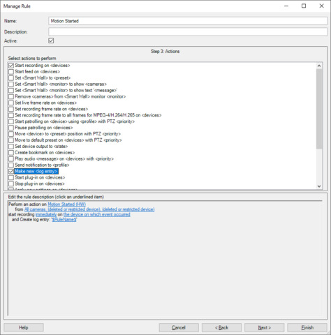

I created a rule in Milestone to start recording on the tns1:RecordingHistory/Recording/State - IsRecording raising and stop recording if IsRecording is falling.
The rule is never triggered even though I receive the event (see the wireshark capture).

You will never see the event in server log if you don’t select “Make ne” in the rule as shown on the screen shot . If you do it as shown in logs you will see the name of the rule(Motion Started in this case) not the name of the event. You can configure to see the name of the event if you want.
If recording is not starting check recording tab on the camera settings. Event looks ok in Wireshark and should work.
