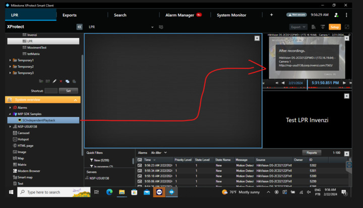

I would like to mention a tip for investigating issues like this.
I create a view with the SCIndependentPlayback plugin used in the view, configured to use a camera and I can see it working. Then I use the ConfigAPIClient to see what that veiw contains. I can see the View Item definition XML.This is relevant because you can then see the “SelectFQID” option and what it contains.
Now I can guide you what your code should look like to make sure you serialize the FQID to make it useful.

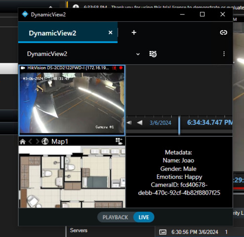

No, only appears the Item view of Playback with the indicators command (Play, Pause, Foward…)
But don’t open the Playback from camera. As you can see in the image below.

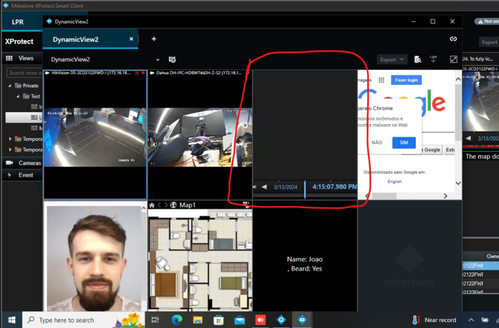

Ok, I will try to use this samples, but I need to link a camera to the Playback first.
This is not working yet, nevertheless with the code that you indicate to me.
Above I show you the problem, only open the ItemView in blank.
So to clarify the point we are now, I’m having two problems yet to solve:
  1. Link a Camera to a Playback in DynamicView.
This is the code that I try to use to link the camera to the SCIndependentPlayck opened in a DynamicView, but don’t work.
FQID cameraFQID = alarm.EventHeader.Source.FQID;
var test = cameraFQID.ToXmlNode();
var test2 = test.OuterXml;
string StringToUse = new System.Xml.Linq.XText(test2).ToString();
viewAndLayoutItem.InsertViewItemPlugin(index++, new SCIndependentPlaybackViewItemPlugin(),
    new Dictionary<string, string>()
         { "SelectFQID", StringToUse }
  1. When I will open the DynamicView with the Playback I need to open 5 seconds before the alarm.
Here I will use the ImageViewerAddOn plugin to make this control, but first I need the image of camera in the playback.
Please Bo, I’m running out of time to deliver this solution, could you help me with these two points, I make myself available to make a call to clear up doubts.
Att…
João Pedro
In the SCIndependentPlayback sample (SCIndependentPlaybackViewItemManager.cs) it uses
SetProperty("SelectedFQID", _selectedCamera.FQID.ToXmlNode().OuterXml);
It seems you are using the sample code direct, I wonder if you have really changed SelectedFQID to SelectFQID, otherwise this might be a typo.
Also, I might be mistaken and you need to use test2 instead of StringToUse so that you get the OuterXml, the SetProperty above seems to indicate this.
I hope this helps I have not tried what you are attempting to do.

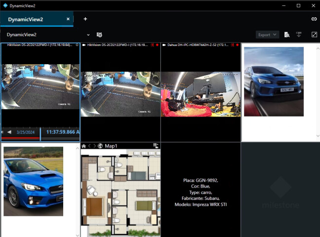

Bo Thanks so much! I used the info of the cameraFQID in XML and appereantely works now!!
The code are like this:
var properties = cameraFQID.ToXmlNode().OuterXml;
viewAndLayoutItem.InsertViewItemPlugin(index++, new SCIndependentPlaybackViewItemPlugin(), new Dictionary<string, string>() { { "SelectedFQID", properties } });
I will try now the commands with ImageViewerAddOn to open this playback some seconds before.
Bo, now to finish this feature I need to play this playback in DynamicView as I mentioned to you.
I’m in trouble to make this work, doesn’t matter what I do the playback always open paused and in the actual datetime.
I’m Using the code below to make the command of playback, but did not work
SCIndependentPlaybackViewItemPlugin _viewItemPlugin = new SCIndependentPlaybackViewItemPlugin();
timeFromEvent = alarm.EventHeader.Timestamp.ToLocalTime().AddSeconds(-5);
viewAndLayoutItem.InsertViewItemPlugin(index++, _viewItemPlugin, new Dictionary<string, string>() { { "SelectedFQID", properties } });
Collection<object> resultCollection = null;
ClientControl.Instance.CallOnUiThread(() =>
	resultCollection = EnvironmentManager.Instance.SendMessage(new VideoOS.Platform.Messaging.Message(MessageId.SmartClient.PlaybackIndication, _viewItemPlugin), null, null);
if (resultCollection != null && resultCollection.Count > 0 && resultCollection[0].GetType().Equals(typeof(FQID)))
	PlaybackCommandData playbackCommandData = new PlaybackCommandData()
		Command = PlaybackData.Goto,
		DateTime = timeFromEvent,
		Speed = 0
	EnvironmentManager.Instance.PostMessage(new VideoOS.Platform.Messaging.Message(MessageId.SmartClient.PlaybackCommand, playbackCommandData), (FQID)resultCollection[0], null);
You mentioned to use the ImageViewerAddOn, but I don’t find the path to attach my playback oppened with the classes and objects that ImageViewerAddOn provide. Can you show me a example, using the commands of playback?
Att…
