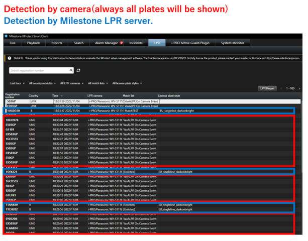

What was worked as expected.
​Detected plate on camera side were shown on LPR tab without camera registration to LPR server.

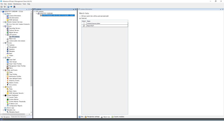

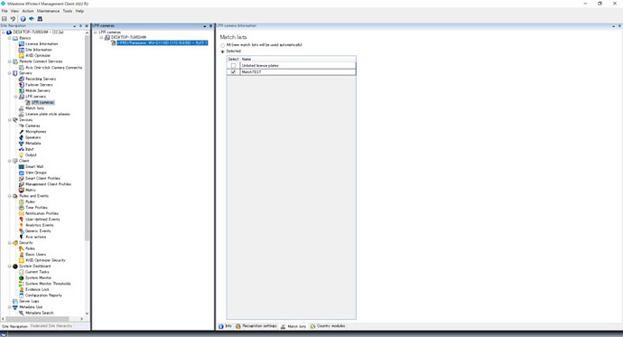

What was not worked.
​It was not possible to display only matching plate events on LPR tab for plates in the matching list registered on the LPR server even if we register the same camera to LPR server and configure “Math lists”.

Our estimation
Plate match processing on LPR server side cannot be applied for plates that camera side detect.
Is our understanding correct ?
