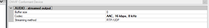

We can currently test with MIlestone Management Client, however it looks like it does not take into account the changes of the configuration of the speaker.
When we change any of the settings we would expect the VMS to update the media1 configuration with a profile and appropriate audio decoder (output) configuration.
The VMS queries only for stream URI (`GetStreamUri`) but it is done for the same, unchanged profile, chosen in advance before during the `Add Hardware` process.
This leads to not being able to alter the config (codec, bitrate, sample rate) for push-to-talk at all and the user is left with the config set automatically by the vms.

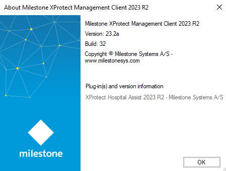

Milestone sys used
