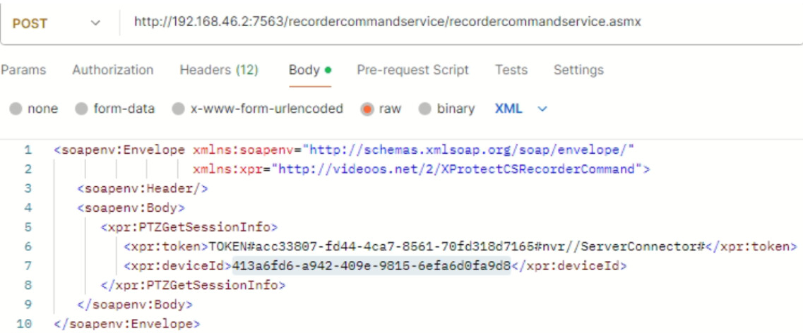

Patrolling API - what API should be used to get a list of available patrols per camera?

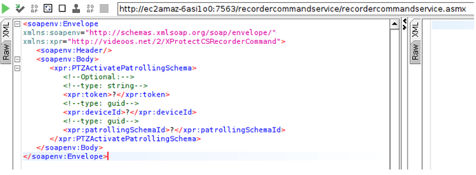

I want to be able to trigger patrolling by an API call. As I understand, the API to call is this one:
But, I need a “patrollingSchemaId” GUID to call this API.

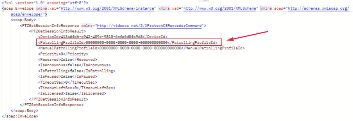

I have tried this one (the only API we found by “Patrol” keyword search):
Given that I know this camera has 2 Patrols, I get this response:
that looks incorrect.
How can I find an API to get a list of available patrols per camera (same as I can get a list of available PTZ Presets per camera) ?

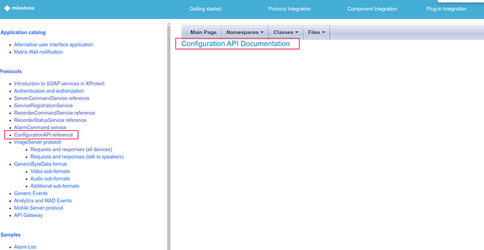

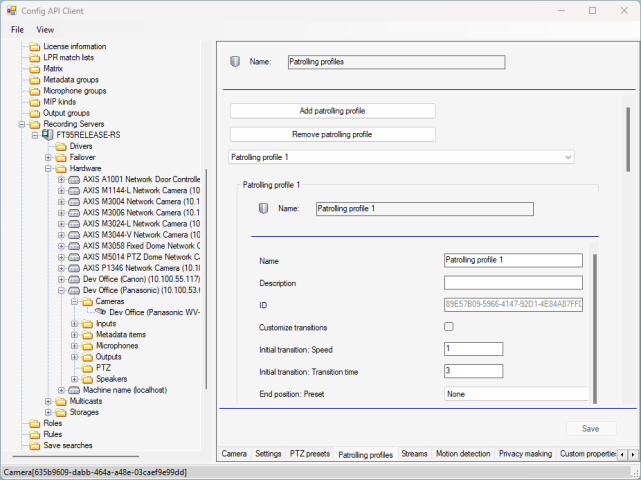

What you are searching for is setup, and the Configuration API can give you this using SOAP protocol.
You can see it in action if you explore the Config API Client sample.
https://doc.developer.milestonesys.com/html/index.html?base=gettingstarted/intro_configurationapi.html&tree=tree_4.html
https://doc.developer.milestonesys.com/html/index.html?base=samples/componentsamples/configapiclient/readme.html&tree=tree_2.html

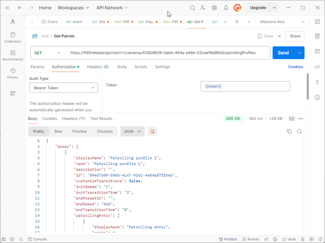

It is also possible to use Rest API
https://doc.developer.milestonesys.com/mipvmsapi/api/config-rest/v1/#tag/Core/operation/getpatrollingProfilesById

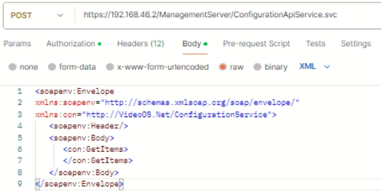

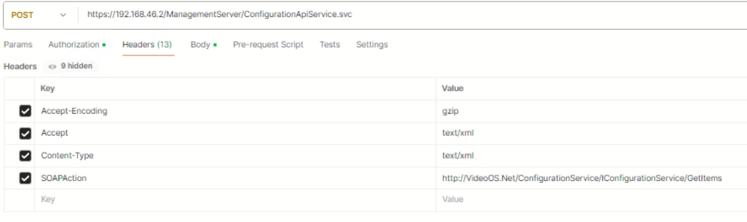

I used SOAP protocol /ManagementServer/ConfigurationApiService.svc?wsdl
and still cannot find a proper request.
The one that I have tried (with Basic auth):

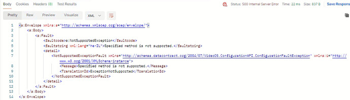

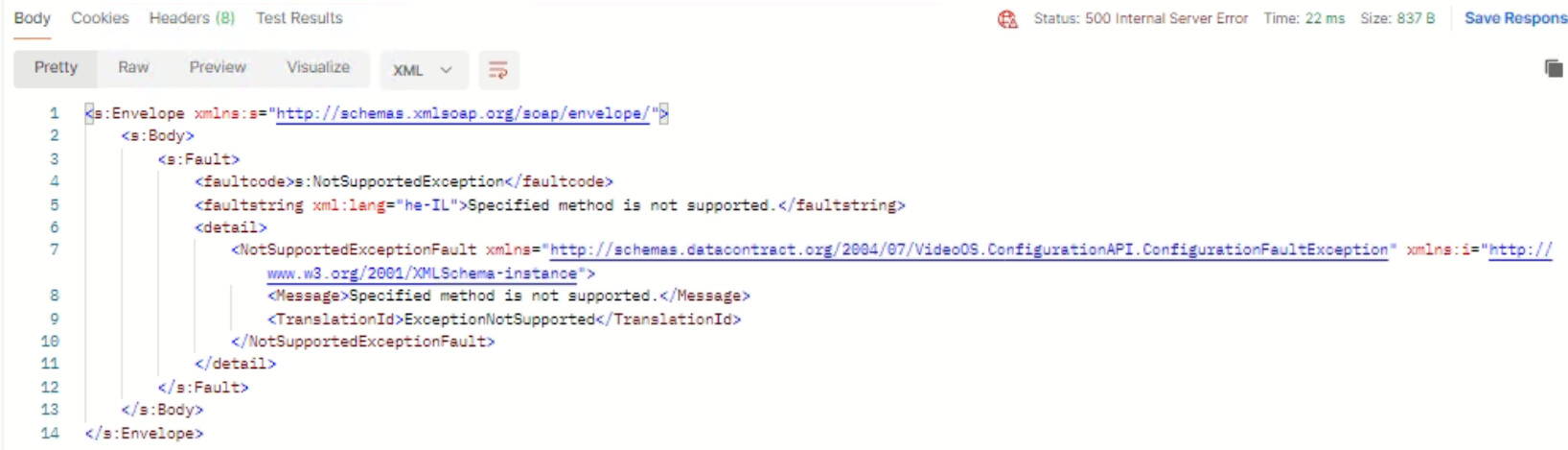

And I got:
I really recommend to use the Rest API instead, it is the newest and recommended API now.
