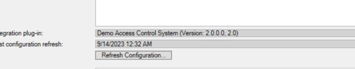

I need to sync cardholders, objects every hour. The result should be like clicking button “Refresh Configuration” in XProtect Management

The answer is No you cannot run the “StartFetchConfiguration()” to sync the cardholders or to refresh the configuration periodically.
I have been testing your case and some changes need to be done to enable this feature. Currently, “refresh configuration” is only possible through the “refresh configuration” button in the Management Client.
This will ensure the atomicity of the procedure when executed by several management clients. In addition, refreshing configuration form the Management Client allows the user to view and verify the retrieved configuration.
The method “StartFetchConfiguration()” is required to be overwritten and implemented by your MIP Plugin to allow MIP fetch new configurations from your Access Control system. It is not meant to be run periodically from your integration as it won’t make any effect on the system.
