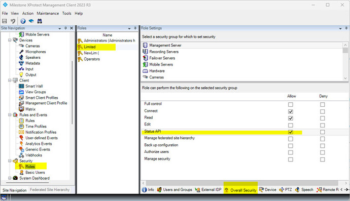

The permission for the Recorder Status is different and kept for itself. It is a permission under “Overall Security” and the “Management Server”..
Allow me to illustrate..
