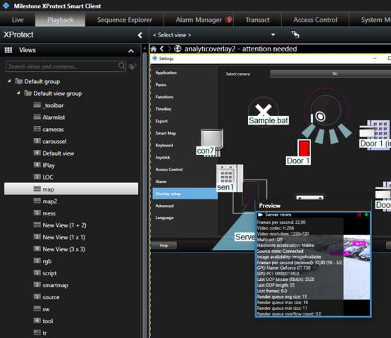

Smart web application?
Is that the Smart Client?
This is built-in functionality: When you hover over a camera you get live footage.
I feel I am guessing, so if this does not fit what you are asking for please elaborate on what you want. Perhaps a screen capture from you could help me understand.
