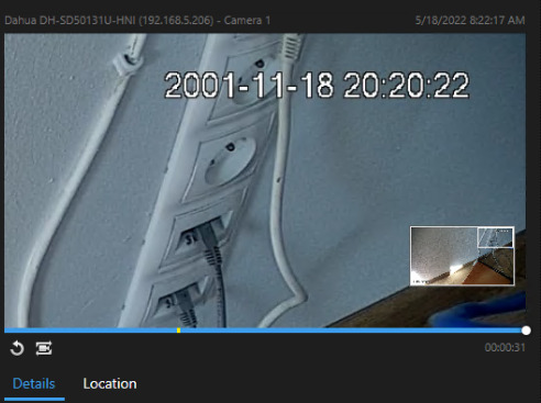

I need the same player like in Smart Client when you search for bookmarks (start time, end time, triggered time marked on the timeline):

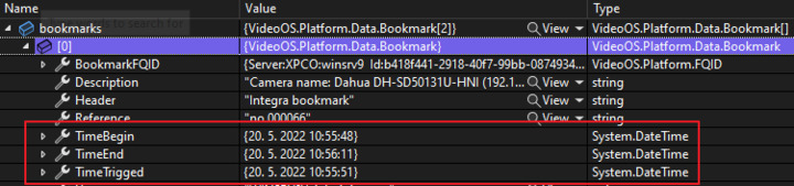

Bookmark time from GetBookmark is a standard .net DateTime:
BookmarkService.Instance.BookmarkGet(bookmarkFqid);
Why and how should I convert it?

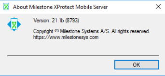

Which version is your XProtect Mobile Server?
Mobile server:

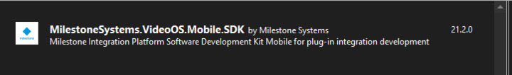

SDK:
Mobile Server 21.1 does not support time range playback

Which version supports time range playback?
Hi,
It was introduced in 21.2
/Svetlana
