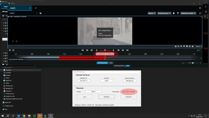

Bo, attached you will find the source code of a ‘particular’ plugin, it is a simple listener able to receive and execute 3 commands: Live, Playback and Snapshot. There is also a small test program for sending these commands.

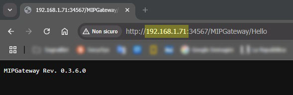

To make sure the listener is active type the image string, the plugin must respond to you.
Of course you must have restarted ES and loaded SC.
Many Thanks,
Frediano
In my browser I get ERR_CONNECTION_REFUSED
Any idea why I cannot use your plugin and test app?
Before to use Test app you need to start SC, with plugin, in order to perform commands.
This is what I am doing. Yet I still get ERR_CONNECTION_REFUSED.
