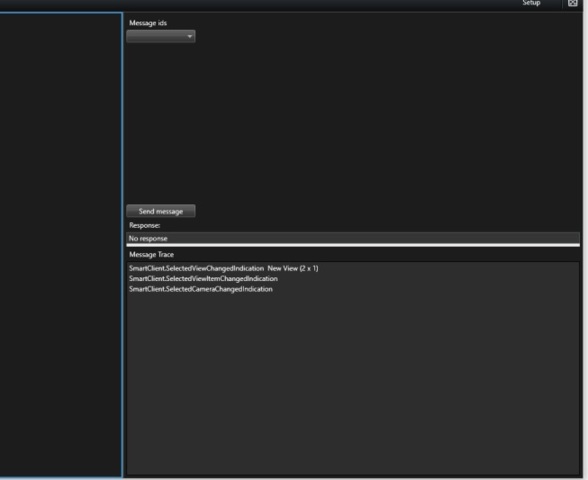

Does the plugin get any message indication upon reload configuration using the keyboard shortcut?

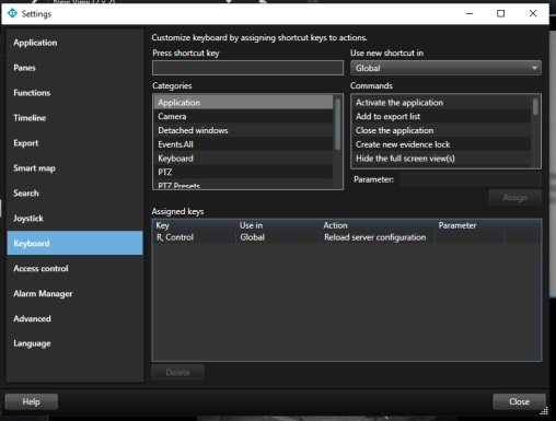

shortcut created in SC
Upon keyboard shortcut
Not getting any message indication so the plugin can capture and take action
Any way to capture reload configuration using a keyboard shortcut?

To reload configuration also reload the plugin. This means, you close Smart Client and restart it when you reload it: means that the plugin is no longer there when you reload, because SC is not alive. That is why it is not possible to get a message from the plugin.
