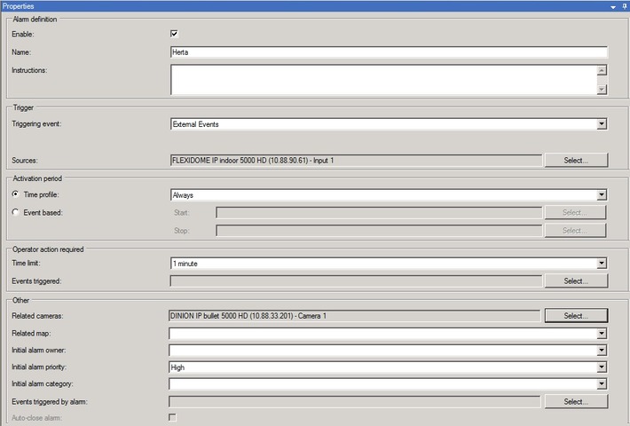

Dear Andersen,
We had use user-defined-event to define an alarm message as attached. Please advance how we could get the related camera info after received the alarm message, thx.
KennethT
I am guessing you subscribe to NewEventsIndication, if you instead subscribe to NewAlarmIndication you can cast the message.Data as Alarm and then you can use the ReferenceList property to get the related camera list as setup in the alarm definition.
