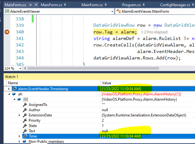

Put a break point on the line “row.Tag = alarm;” to see time and timestamp.
Run the sample.
See alarm.EventHeader.Timestamp and Alarm history time, it is the same time (if the alarm has only one status).

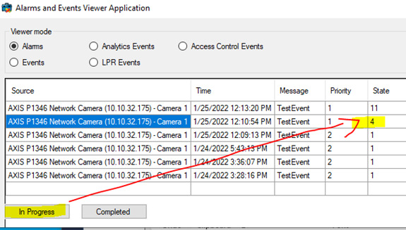

When you see the dialog, select an alarm which has status 1 from the alarm list.
Click “In Progress” and see the status number changes from 1 to 4.

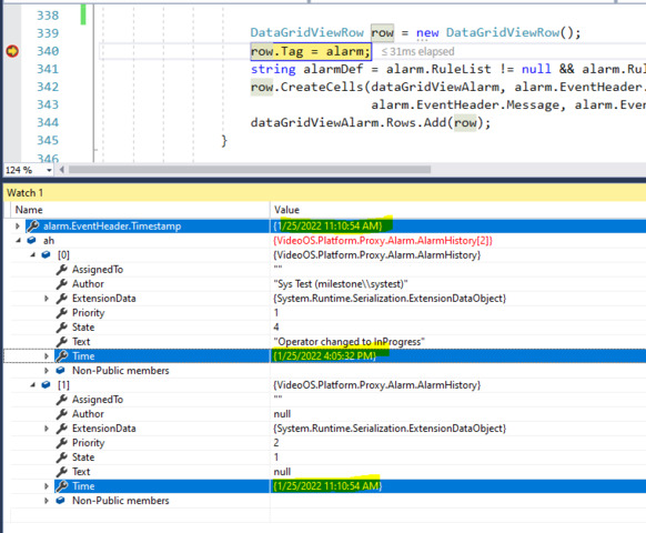

Click Events radio button and click Alarms radio button again.
Then go back to the break point.
It shows you the AlarmHistory(ah) is increasing, ah[1] has start time but ah[0] has time of changing the status to “In Progress”.
Hi Rie!
I’m familiar with the nature of AlarmHistory in that it is an array of events that have occured on the alarm; What’s strange is that there is only one AlarmHistory element for this particular alarm (at the time of logging), despite what was pulled into the Created property having a different time from that single AlarmHistory element. So I wonder if an individual AlarmHistory instance (not the array but a single AlarmHistory class instance) can have its Timestamp changed?
