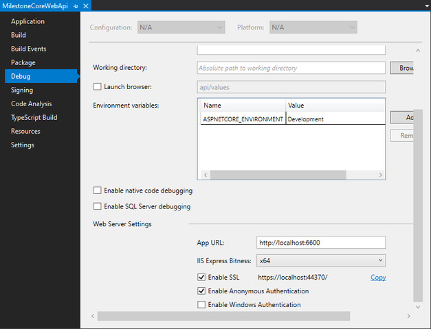

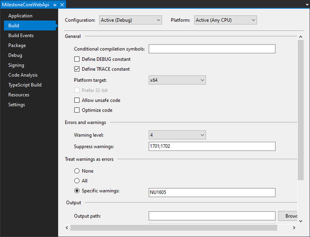

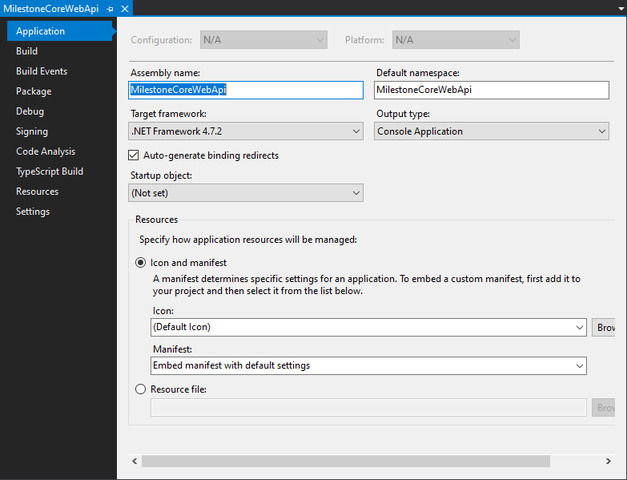

When I wrote an ASP.NET Core project (targetting .NET Framework 4.7) I ran into similar issues. Here are the project properties I needed to set to make sure it worked properly:
  1. Target .NET Framework (if you’re building an ASP.NET Core site, it’ll need to target framework instead of core)
  2. Platform target must be x64
  3. IIS Express Bitness should be x64
Here’s some screenshots:
